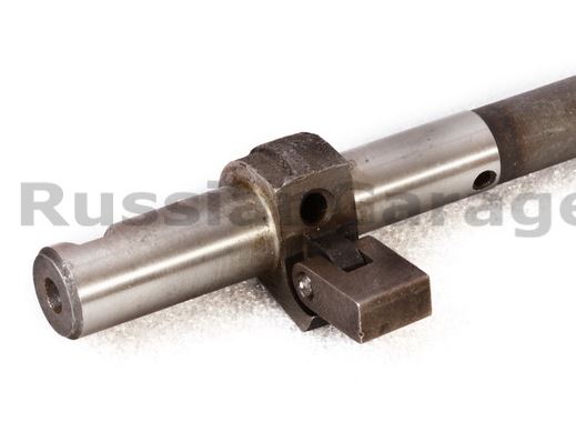

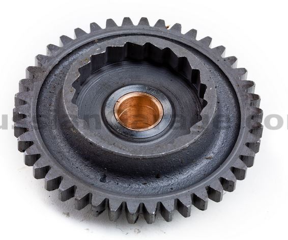

The sound comes from the kickstarter gear (displayed below) and is generated by the small iron assembly on the kick starter shaft (see pic below).

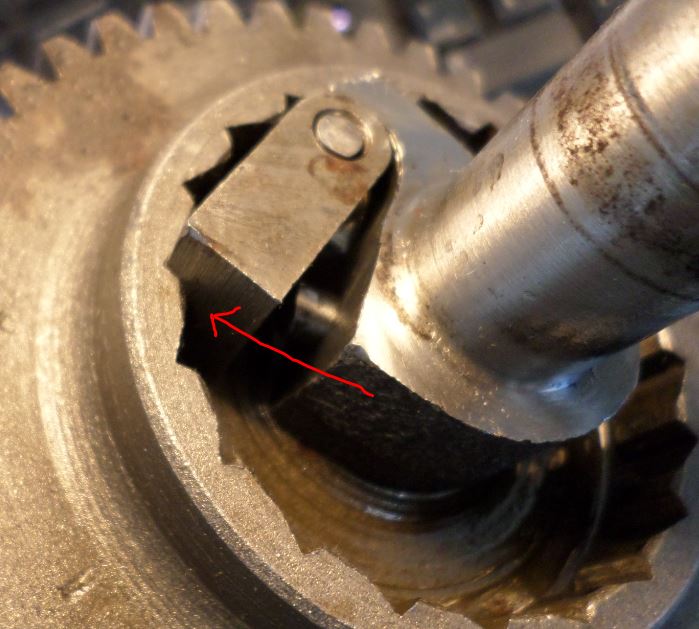

Hi there yes indeed. I think it's indeed related to the "flip" on the shaft but I checked that and it could move. It did not go smooth though... do you (or anyone else) actually know how the "flip" should function? Like you said simply opening and closing freely? It looked to me there was some spring inside pushing it outside...on the spot where there's the red arrow...
Re: URAL Gearbox makes constant kickstarter noise.
if you should have any spring there, it would definitively create that sound.i think it should be freely movable or with a very easy spring. when correctly working, the flip would be not in contact with teeth during normal run. when you want to start it needs to be extended and it should be working on gravity or motion of the shaft. consult with parts catalog

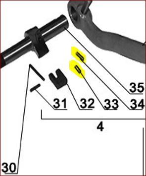

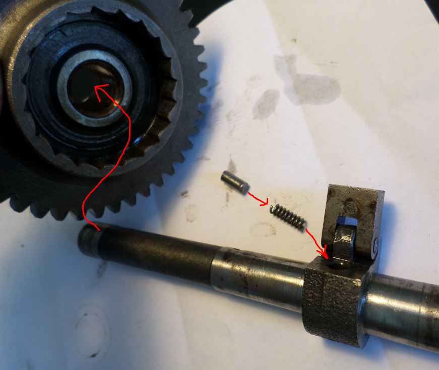

I just took the kickstarter gear out and disassembled it. See pics below. Indeed: spring and pin that pushes the block outside, this is also how it should be according the parts catalog (see other pics).
I agree with your statements about a very easy spring (it is not an easy spring) but I find it strange that there is a spring in it that is too strong.... The bike is not mine and hasn't driven for a few years but it does not look to me that someone "improved this".... mystery... what would you do? Take the whole spring out and see?!
Thanks, Stephan.
i would just use a spring from a pen to test it. it has to have correct length and sufficient power to rise the flip. check if the sound is gone if you remove the spring

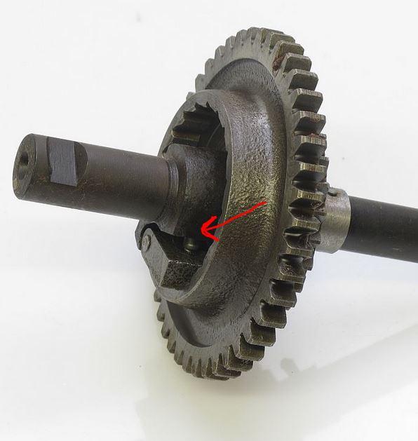

Everything on pictures is OK. Problem is the shaft and return string wrong assembled. You have to seat the return spring properly during gearbox case assembly. This spring keeps the shaft at angle where some part of the case keeps the flip closed when kick start lever is in top up position.

Fixed it. The spring was not the problem. It's apparently just a matter of correct assembly. I made some pics. If I have time I'll explain the essentials.
